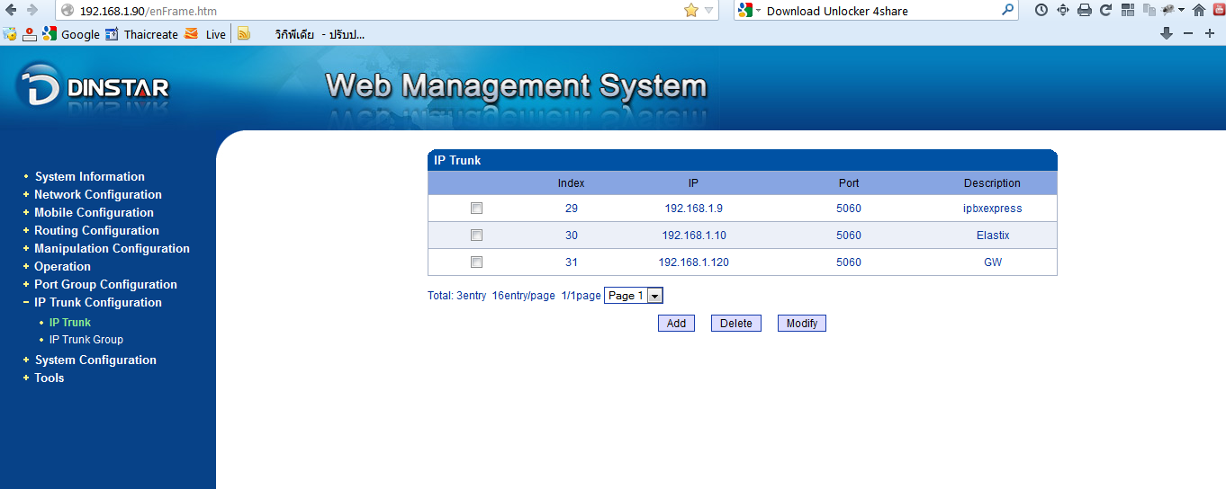

ผมต่อเข้า GSM GETWAY ip 192.168.1.19 แบบ 8 Sip
ยี่ห้อ Destart
มีขั้นตอน Set อย่างไรครับ

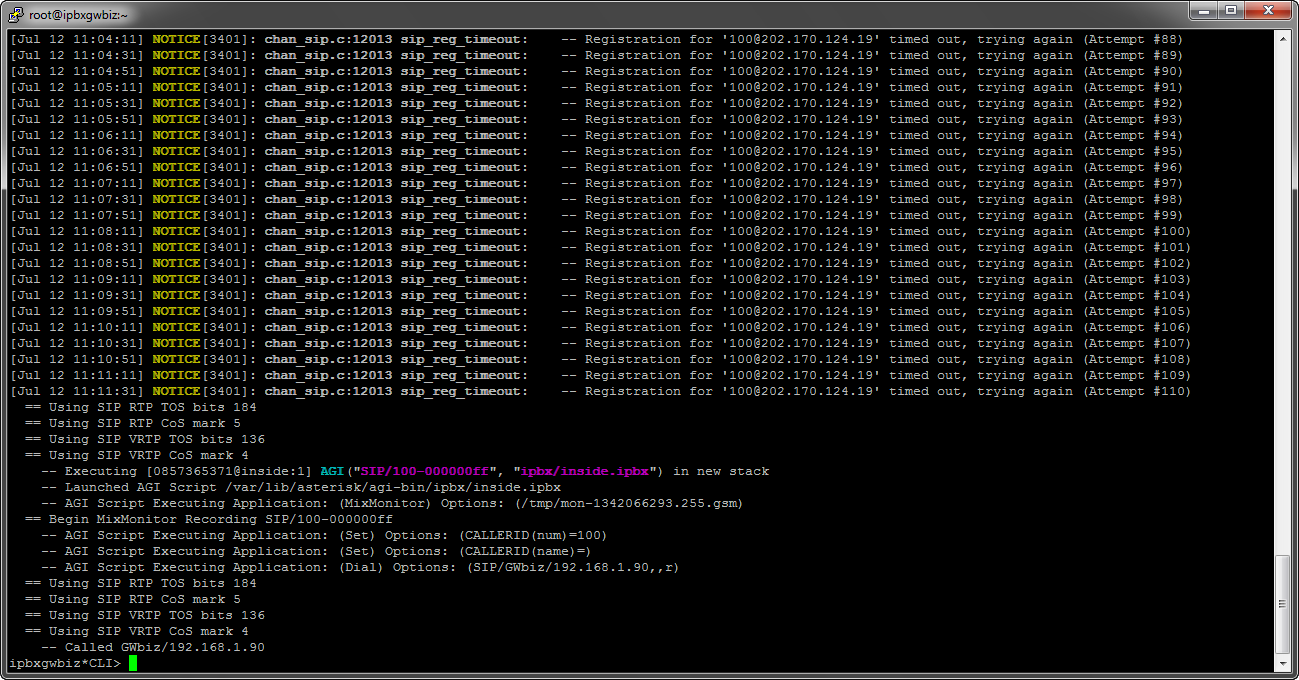

== Spawn extension (inside, h, 1) exited non-zero on 'SIP/100-000000ef'
== End MixMonitor Recording SIP/100-000000ef

-- Executing [0857365371@inside:1] AGI("SIP/100-000000f1", "ipbx/inside.ipbx") in new stack
-- Launched AGI Script /var/lib/asterisk/agi-bin/ipbx/inside.ipbx
-- AGI Script Executing Application: (MixMonitor) Options: (/tmp/mon-1342064375.241.gsm)
== Begin MixMonitor Recording SIP/100-000000f1
-- AGI Script Executing Application: (Set) Options: (CALLERID(num)=100)
-- AGI Script Executing Application: (Set) Options: (CALLERID(name)=)
-- AGI Script Executing Application: (Dial) Options: (SIP/GWbiz/202.170.124.19,,r)
== Using SIP RTP TOS bits 184
== Using SIP RTP CoS mark 5
== Using SIP VRTP TOS bits 136
== Using SIP VRTP CoS mark 4
-- Called GWbiz/202.170.124.19
[Jul 12 10:39:51] NOTICE[3401]: chan_sip.c:12013 sip_reg_timeout: -- Registration for '100@202.170.124.19' timed out, trying again (Attempt #15)
-- SIP/GWbiz-000000f2 is circuit-busy
== Everyone is busy/congested at this time (1:0/1/0)
-- <SIP/100-000000f1>AGI Script ipbx/inside.ipbx completed, returning 0
-- Auto fallthrough, channel 'SIP/100-000000f1' status is 'CONGESTION'
-- Executing [h@inside:1] Hangup("SIP/100-000000f1", "") in new stack
== Spawn extension (inside, h, 1) exited non-zero on 'SIP/100-000000f1'
== End MixMonitor Recording SIP/100-000000f1

-- Executing [0857365371@inside:1] AGI("SIP/100-000000f3", "ipbx/inside.ipbx") in new stack
-- AGI Script Executing Application: (MixMonitor) Options: (/tmp/mon-1342064491.243.gsm)
== Begin MixMonitor Recording SIP/100-000000f3
-- AGI Script Executing Application: (Dial) Options: (SIP/GWbiz/192.168.1.90,,r)
-- Called GWbiz/192.168.1.90
[Jul 12 10:41:41] WARNING[3401]: chan_sip.c:24794 build_peer: Qualification of peer '101' should be 'yes', 'no', or a number of milliseconds at line 0 of sip.conf
-- Executing [8877668058062@inside:1] AGI("SIP/101-000000f5", "ipbx/inside.ipbx") in new stack
-- AGI Script Executing Application: (MixMonitor) Options: (/tmp/mon-1342064501.245.gsm)
== Begin MixMonitor Recording SIP/101-000000f5
[Jul 12 10:41:41] NOTICE[18408]: chan_sip.c:5934 update_call_counter: Call to peer 'GWbiz' rejected due to usage limit of 1
-- Couldn't call GWbiz/192.168.1.90
== Everyone is busy/congested at this time (0:0/0/0)
-- <SIP/101-000000f5>AGI Script ipbx/inside.ipbx completed, returning 0
-- Auto fallthrough, channel 'SIP/101-000000f5' status is 'CHANUNAVAIL'
-- Executing [h@inside:1] Hangup("SIP/101-000000f5", "") in new stack
== Spawn extension (inside, h, 1) exited non-zero on 'SIP/101-000000f5'
== End MixMonitor Recording SIP/101-000000f5
[Jul 12 10:41:51] NOTICE[3401]: chan_sip.c:12013 sip_reg_timeout: -- Registration for '100@202.170.124.19' timed out, trying again (Attempt #21)
-- SIP/GWbiz-000000f4 is circuit-busy
-- <SIP/100-000000f3>AGI Script ipbx/inside.ipbx completed, returning 0
-- Auto fallthrough, channel 'SIP/100-000000f3' status is 'CONGESTION'
-- Executing [h@inside:1] Hangup("SIP/100-000000f3", "") in new stack
== Spawn extension (inside, h, 1) exited non-zero on 'SIP/100-000000f3'
== End MixMonitor Recording SIP/100-000000f3

[Jul 12 10:53:51] NOTICE[3401]: chan_sip.c:12013 sip_reg_timeout: -- Registration for '100@202.170.124.19' timed out, trying again (Attempt #57)
[Jul 12 10:54:11] NOTICE[3401]: chan_sip.c:12013 sip_reg_timeout: -- Registration for '100@202.170.124.19' timed out, trying again (Attempt #58)
[Jul 12 10:54:31] NOTICE[3401]: chan_sip.c:12013 sip_reg_timeout: -- Registration for '100@202.170.124.19' timed out, trying again (Attempt #59)
[Jul 12 10:54:51] NOTICE[3401]: chan_sip.c:12013 sip_reg_timeout: -- Registration for '100@202.170.124.19' timed out, trying again (Attempt #60)
[Jul 12 10:55:11] NOTICE[3401]: chan_sip.c:12013 sip_reg_timeout: -- Registration for '100@202.170.124.19' timed out, trying again (Attempt #61)
[Jul 12 10:55:31] NOTICE[3401]: chan_sip.c:12013 sip_reg_timeout: -- Registration for '100@202.170.124.19' timed out, trying again (Attempt #62)
[Jul 12 10:55:51] NOTICE[3401]: chan_sip.c:12013 sip_reg_timeout: -- Registration for '100@202.170.124.19' timed out, trying again (Attempt #63)
[Jul 12 10:56:11] NOTICE[3401]: chan_sip.c:12013 sip_reg_timeout: -- Registration for '100@202.170.124.19' timed out, trying again (Attempt #64)
[Jul 12 10:56:31] NOTICE[3401]: chan_sip.c:12013 sip_reg_timeout: -- Registration for '100@202.170.124.19' timed out, trying again (Attempt #65)
[Jul 12 10:56:51] NOTICE[3401]: chan_sip.c:12013 sip_reg_timeout: -- Registration for '100@202.170.124.19' timed out, trying again (Attempt #66)
[Jul 12 10:57:11] NOTICE[3401]: chan_sip.c:12013 sip_reg_timeout: -- Registration for '100@202.170.124.19' timed out, trying again (Attempt #67)
[Jul 12 10:57:31] NOTICE[3401]: chan_sip.c:12013 sip_reg_timeout: -- Registration for '100@202.170.124.19' timed out, trying again (Attempt #68)
[Jul 12 10:57:51] NOTICE[3401]: chan_sip.c:12013 sip_reg_timeout: -- Registration for '100@202.170.124.19' timed out, trying again (Attempt #69)
[Jul 12 10:58:00] WARNING[3401]: chan_sip.c:24794 build_peer: Qualification of peer '101' should be 'yes', 'no', or a number of milliseconds at line 0 of sip.conf
[Jul 12 10:58:01] WARNING[3401]: chan_sip.c:24794 build_peer: Qualification of peer '101' should be 'yes', 'no', or a number of milliseconds at line 0 of sip.conf
-- Executing [0878058062@inside:1] AGI("SIP/101-000000fb", "ipbx/inside.ipbx") in new stack
-- AGI Script Executing Application: (MixMonitor) Options: (/tmp/mon-1342065481.251.gsm)
== Begin MixMonitor Recording SIP/101-000000fb
[Jul 12 10:58:11] NOTICE[3401]: chan_sip.c:12013 sip_reg_timeout: -- Registration for '100@202.170.124.19' timed out, trying again (Attempt #70)
-- <SIP/101-000000fb>AGI Script ipbx/inside.ipbx completed, returning 0
-- Executing [h@inside:1] Hangup("SIP/101-000000fb", "") in new stack
== Spawn extension (inside, h, 1) exited non-zero on 'SIP/101-000000fb'
== End MixMonitor Recording SIP/101-000000fb
-- Executing [0857365371@inside:1] AGI("SIP/100-000000fd", "ipbx/inside.ipbx") in new stack
-- AGI Script Executing Application: (MixMonitor) Options: (/tmp/mon-1342065503.253.gsm)
== Begin MixMonitor Recording SIP/100-000000fd
[Jul 12 10:58:31] NOTICE[3401]: chan_sip.c:12013 sip_reg_timeout: -- Registration for '100@202.170.124.19' timed out, trying again (Attempt #71)
ipbxgwbiz*CLI>
